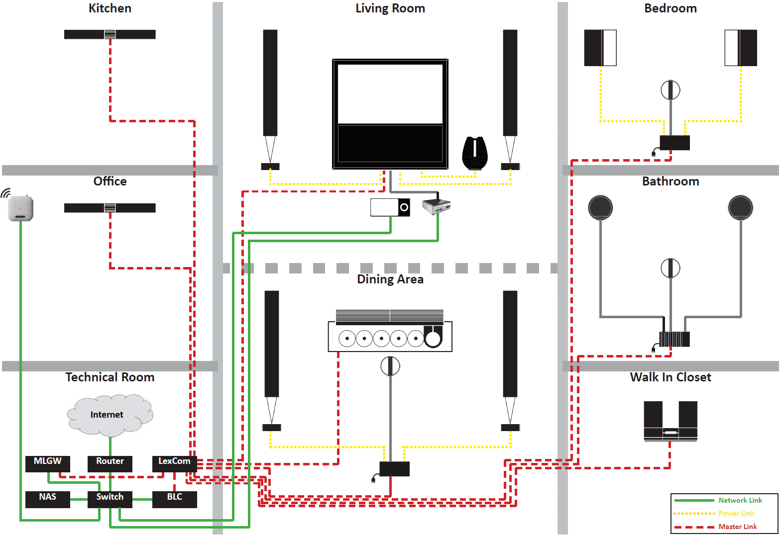

Hello Guy! Well, I do have both Audio/Video master on the ML side. As a refresh, you might remember this
Next what wanted to try out if it's then possible to join the BL3500-BLC to an existing multi-room device such as Beosound Level. This is seconday, so for now first problem to solve if it's possible to get the BL-3500 to play. But, I hope that the above diagram and previous thread gives a bit of insight of how the system is setup.

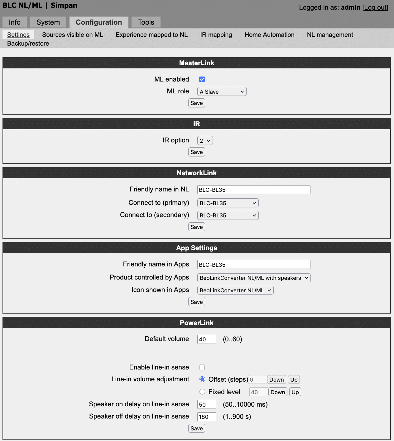

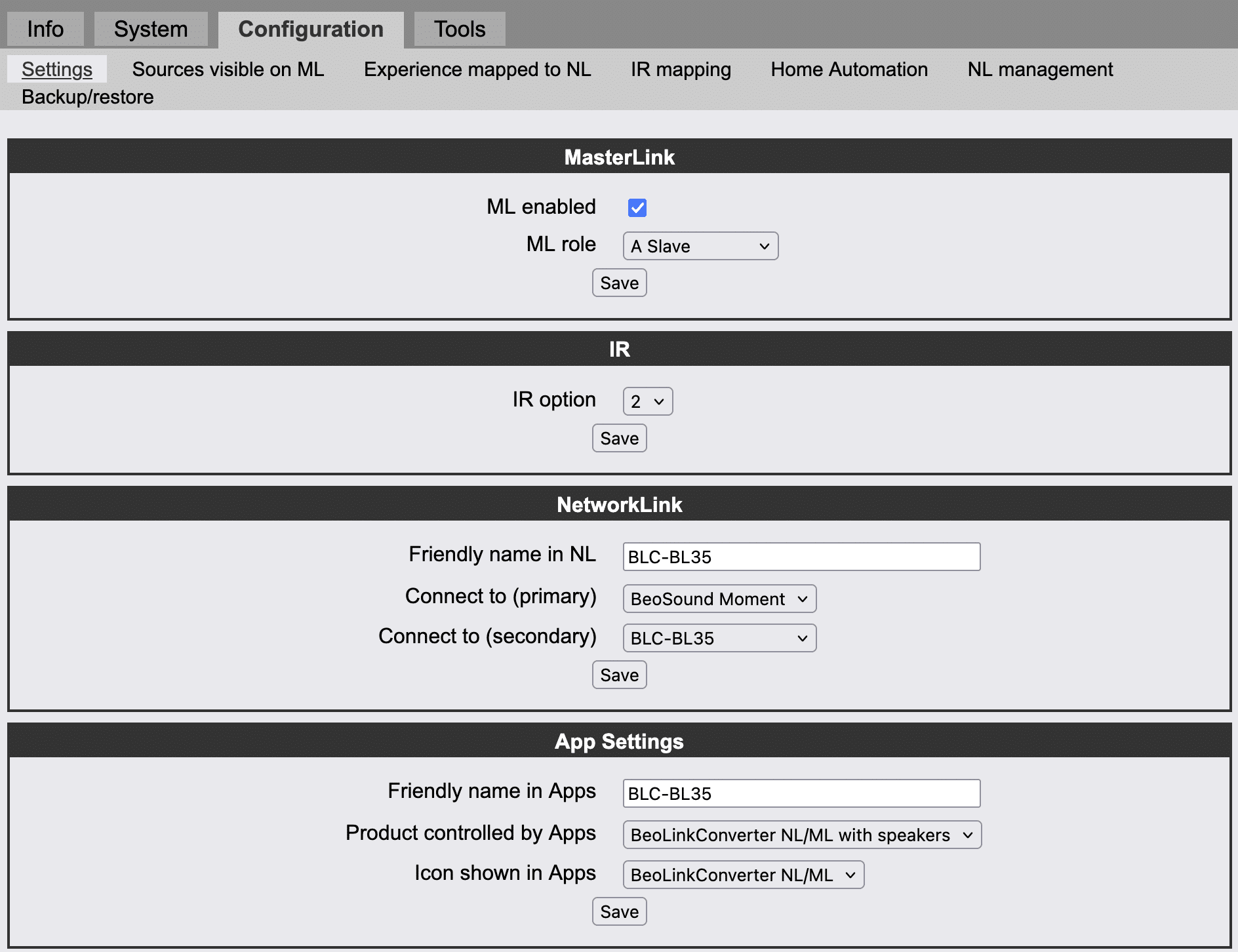

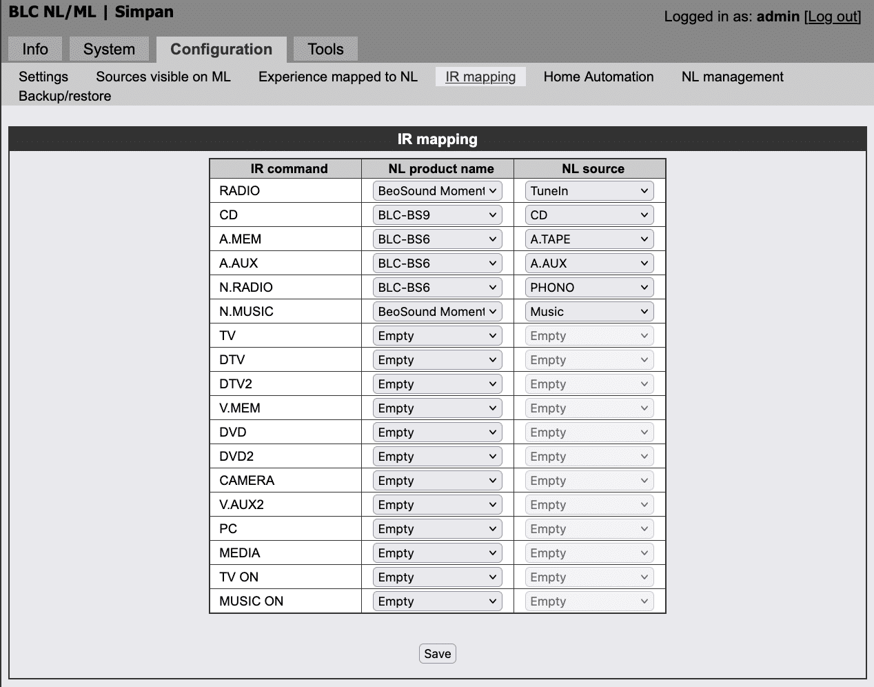

Got hold of 1611 which is not also connected to the BLC together with BL3500 which now makes the BL3500 react to the remote; good stuff! Next step is then to get the configuration correct and for now I don't get any reaction from other units; so something is missing and I'm kind of getting blind to what I've eventually missed. So the idea is then to be able to 1) pull audio from the BV10, Moment, etc., including being able to use the B&O app to play audio (Deezer) to the BL3500. Here is how the current config looks like:
Location: Malmo, Sweden

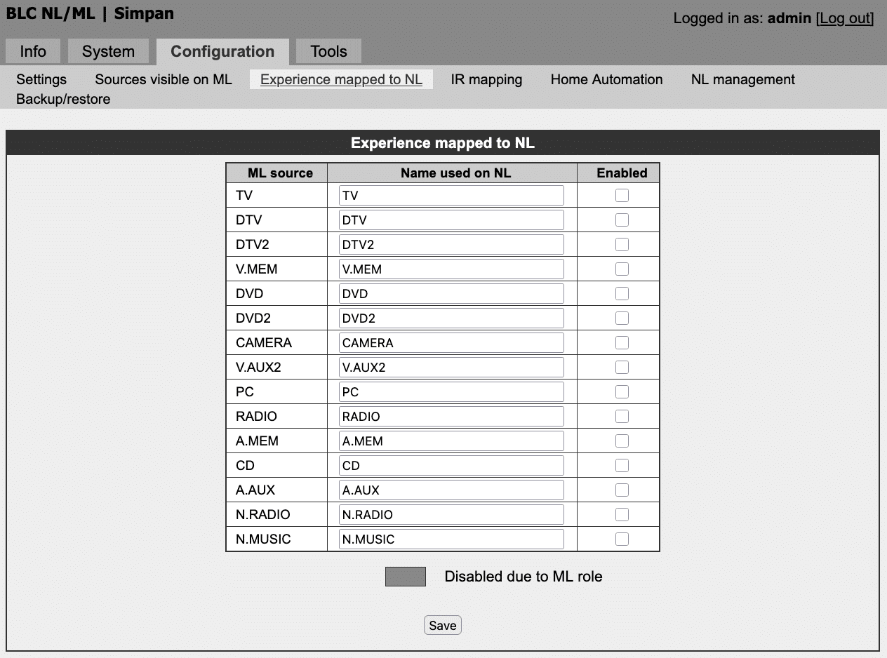

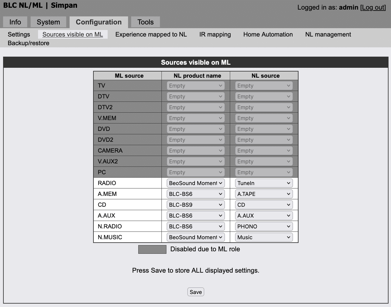

You might want to set theBLC as A.master, V.Master or AV.master On the tab: “sources visible to ML” you will have to define what ML source names your BV10and Moment sources should have when controlled from the BL3500
Location: Denmark
Right, so since the BLC is it's own little ML it needs to have any of the A.master, V.Master or AV.master set and once I've done and tweaked the "Source visible to ML"; I could now play CD's from BS9000 and play cassette from BS6500. But, when trying to play TuneIn (Radio) or Music (N.MUSIC) from the Moment then the BL3500 quickly indicate source and then powers off (including that it also powered off the BS6500 stereo) all other units in the ML-network. To be mentioned is that the Beolink 1611 has fw 1.3 and whether that is an issue or not... So, half there 😀
